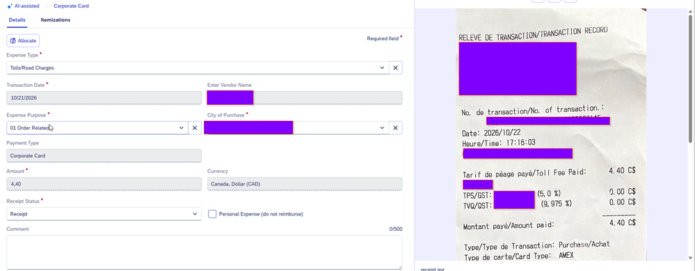

AI Populates Wrong date of transaction
When i Click to submit a expense by uploading the image. The image is very clear and ai populates the wrong date of transaction for almost 90% of the transactions. I cant edit the transaction date manually too. This causes too many rework for 90% of my expenses in the report. The AI atleast allow users to edit the wrongly populated data SAP2.png

Concur’s ExpenseIt uses text recognition (OCR) and machine learning to extract transaction dates—it can read a clear image yet interpret the date incorrectly.
Possible reasons include:
  • Date-format confusion: Concur’s receipt scanning can misread dates because of date formats (DD/MM versus MM/DD), multiple dates on the receipt, or recognition errors, even when the image looks clear.
  • Multiple dates: It may select an invoice, printing, or payment date instead of the purchase date.
  • Recognition errors: Receipt fonts or layouts may cause digits to be misread.
  • Card transaction data: For a matched corporate card expense, the displayed date may come from the card transaction.
If you cannot correct the date:
  • Check whether the expense is linked to a corporate card transaction. The date may come from the card feed rather than the receipt.
  • Ask your Concur administrator to investigate the locked field and confirm how corrections should be handled.

@tag_m The Transaction Date is coming from the card transaction details, not the receipt image. There is a setting that would allow for changing the transaction date, but most companies do not turn this on for various reasons.
The mismatch with the dates shouldn't be an issue. I recommend using the Comment field to provide some explanation. You have no control over the Transaction Date that is brought in. I think your company will understand. 🙂
