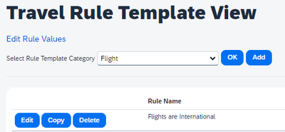

@TriciaW How do I know if I have the correct permissions to build a rule? I can see this when I click on Travel Rule Builder

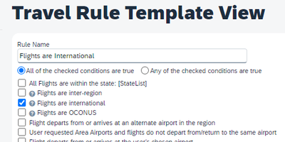

Seems one rule already exist, but when I click on Edit nothing really happens, this is all I can see.

@JCKasai  It looks like you have the correct permissions from your screenshots.  That is where you would be able to Edit the Rule or confirm which Rule Classe(s)the rule is attached to if any.  Once a rule is attached you would need to then find the rule in the rule class and enable it.  If you are unsure how to build/edit a rule, I would suggest to open a case with Concur for assistance.
