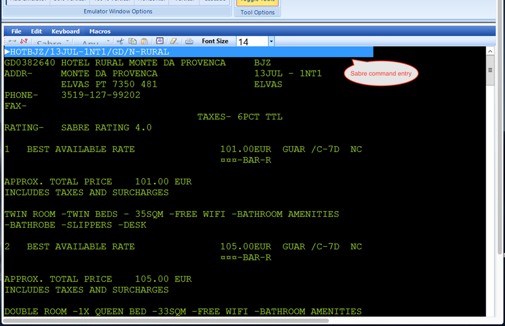

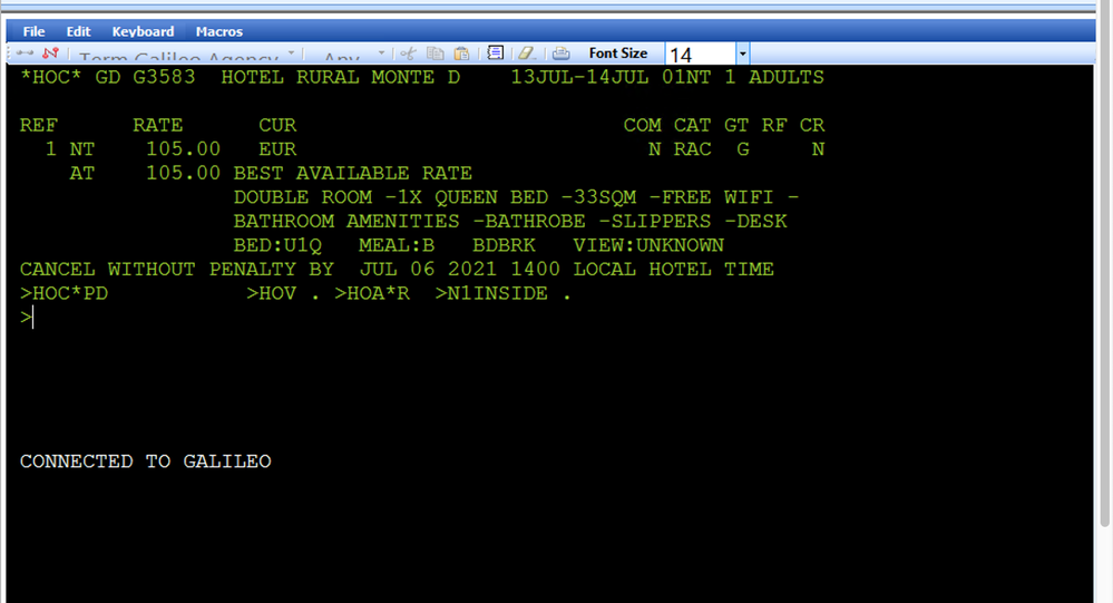

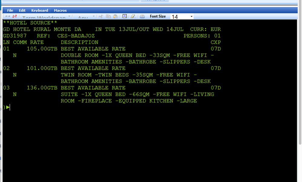

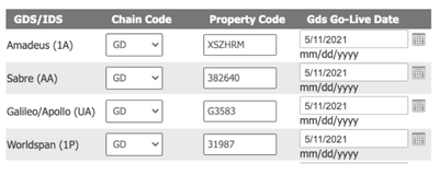

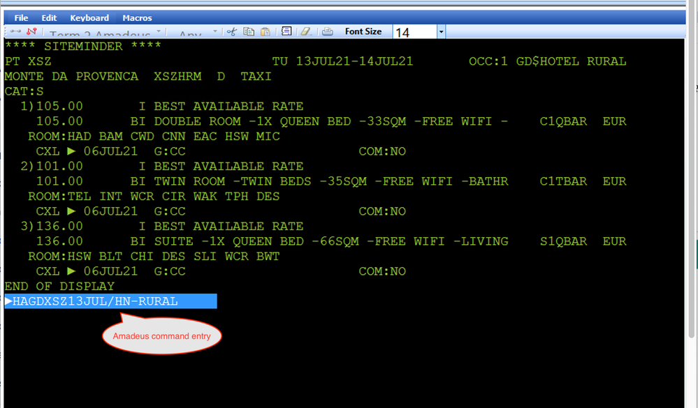

@KevinD the Siteminder.com support (GDS Provider) confirmed that "Hotel Rural Monte da Provenca" is fully active on the following GDS systems: Amadeus, Apollo/Galileo, Sabre and Worldspan (attached availability screenshots from all four different GDS systems).
They said: "If Concur connects to the above GDS systems through a booking tool, then the issue is between their system and the GDS system where you are trying to view your rates/hotel profile. In this case they will need to report this matter to their booking tool provider, to find out the reason why they can't find you in their system."
Amadeus Availabilty CheckAmadeus Availabilty CheckGalileo Availabilty CheckGalileo Availabilty CheckSabre Availability CheckSabre Availability CheckWorldspan Availabilty CheckWorldspan Availabilty Check
