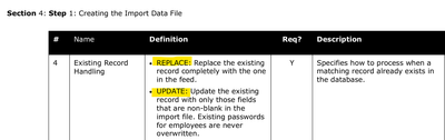

So, it is totally depend on what import settings you are using in your import file. If you are using UPDATE, then it will not replace existing changes which you have done it in profile manually.
If you are using REPLACE then it will replace/overwrite existing changes done it in profile. In this case, I would suggest you doing the same changes in source system as well and going forward, you should do these changes directly in source system so that next day it will get updated in Concur system.
Also, attaching additional information for your further reference:
Thanks!
