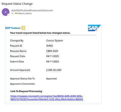

This was asked several years ago but I'm hoping to see if there is any update. There is an automated email that goes to the Traveler when a Travel Request is approved. Is there any way to customize this email? Specifically, I'd like to add an attachment that goes with it that notes some of our most important travel policies.

Yes, that is the email I'm referring to, though ours don't include a print copy of the request or any other attachments currently. I would like to add an attachment of our "Top Ten Travel Reminders" so that people receive those when their trip is approved.

It's just a Word or PDF document that we created. I'd like it to be attached to the email. It's two pages, so just a screenshot wouldn't work.

Hi @katwilliams ,
I tried modifying the email notification and found that adding a hyperlink to the policy document is much easier than using the attachment option. The attachment approach is a bit tricky and time-consuming to implement, and it may not provide the experience you’re expecting. Hence, I'm dropping that option.
Please find below configuration steps:
Role Required - Request Configuration Administrator (Unrestricted)
In case if you don't have unrestricted access then you may need to raise a support case with Concur and request them to add the company policy hyperlink in email notification.
1. Go to Request Workflows >> Email Notifications tab >> Create a copy of "Default Request Status Change Notification"
2. Add policy document link section on page 2 and page 3 as shown below and click Done.
3. Open existing in use workflow >> Link newly created email notification in status change email notification section.
4. Done.
Testing Result
Hope this helps! 🙂

katwilliams
Occasional Member - Level 3
This worked! Thank you so much!
katwilliams
Maybe instead of the "Link to Request Processing" that is currently at the bottom of the email (which doesn't work anyway), we could change that to "Please Read This Before Booking Any Travel" and have a link to the document?
