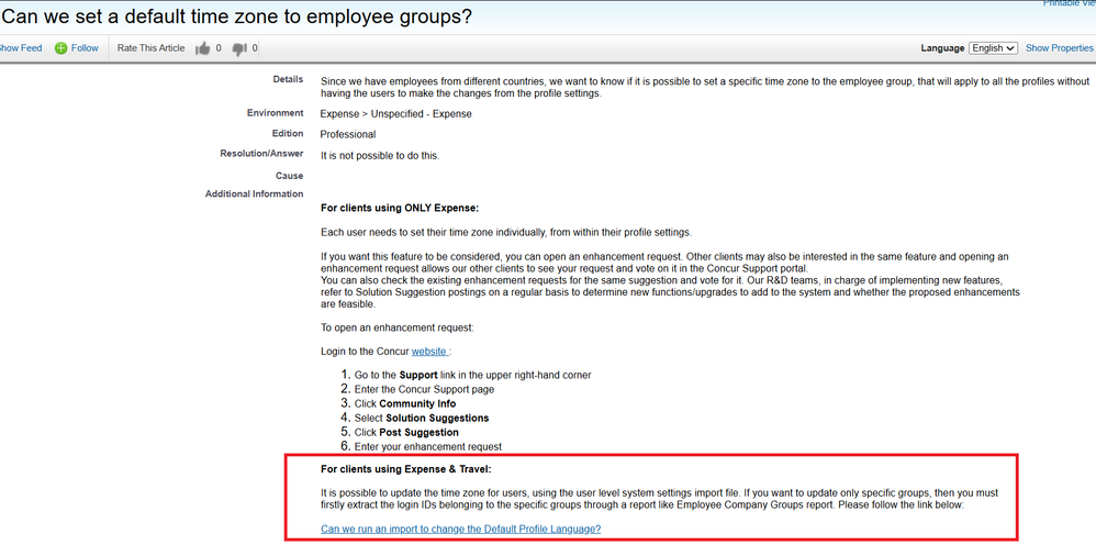

@S_Collins I don't believe this is possible without going in and acting on behalf of each user. You could always write up the steps and have each user make the change themselves. This would likely be the fastest option. I know your concern would be that not everyone does the steps to make the updates.
If you would like to submit an enhancement request, you can visit this link: https://influence.sap.com/go/cis.
PoojaKumatkar
Super User
Super User
Hi @S_Collins ,

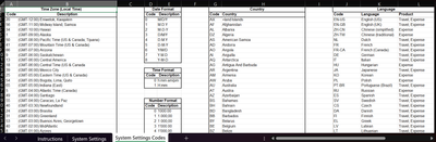

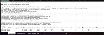

With reference to below article, it is only feasible if you are using Expense & Travel module. If you are using ONLY Expense module then it is not feasible.
Use below URL to download the SystemSettingsImport template. Given in above article:
https://sapconcur.my.site.com/Partners/servlet/fileField?id=0BE7V0000001XhR
Thanks!
