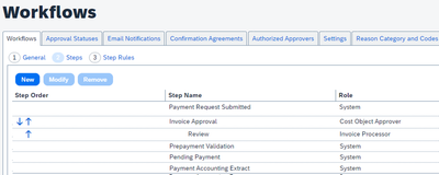

1. Copy default workflow and add cost object approver step into it. On 1st page of workflow under Cost Object Hierarchy Type: select Limit.
Once it is added, workflow steps will look as below:

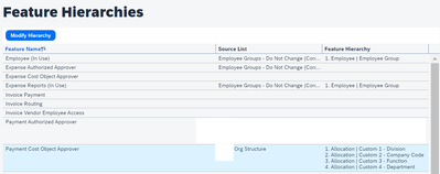

2.  Define feature hierarchy - you can select source list as per your requirement. Meaning, if you want to define approvers based on department/project then you can select org structure under source list. as shown below:

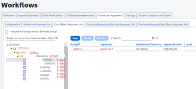

3. Once feature hierarchy is configured, org hierarchy will appear under workflow, cost object approver list where you can define your limit wise approvers as show below:
Here, each department (lower node) has same limit $15000, above that function has $25000 limit, company code has $35000 limit.

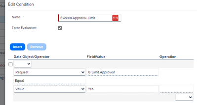

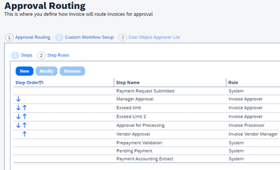

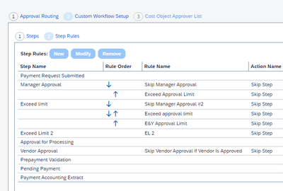

Thank you - see attached.   It is working now in terms of if it exceeds the threshold set for the employee it goes to that employee's manager, I just Can't get that step to repeat multiple times until it doesn't exceed the threshold.  See steps below.
 HERE ARE THE STEP RULES SUMMARY VIEW
DETAILS OF THE "EXCEED APPROVAL LIMIT" STEP: Issue is it only runs once vs repeating until it is true....i.e if invoice is 50K and first approver has 1K limit and his manager is 10K, the rule works to forward, but when the 10K manager approves, the rule doesn't repeat to get to that employee's manager until it reaches an approver with a 50K allowance.
