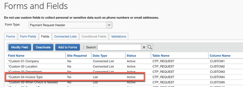

@daniel1cheong I went into your site and it looks like Invoice Type is also using the Custom04 field at the Payment Request Header level. I took a screenshot. See below. This Custom04 and the Custom20 field you mentioned are pulling from the same list, so I think you can report on the Invoice Type. I am not sure if pulling Invoice Type from the Payment Request Header will work for you or not, but you could try it.

Unfortunately the Invoice type at the Payment header level is copied from the Custom 20 - Invoice type field, but the processor can adjust the Invoice type at the Payment Header level.  I need the Custom 20 - Invoice type which is against the vendor record to also be reportable because i need to know when a Customer 20 - Invoice Type against the vendor is classified as a PO but we decide to process this as "Operational" (meaning workflow approval only and not processed with a PO via our ERP).
Can you let me know if you can make Custom fields 16 to 20 part of the reporting database?
@daniel1cheong making those fields available in Reporting is not something I can do. You would have to submit a Support ticket to see if it is possible or if there is a workaround. I'm not 100% sure, but if there was another Custom field in the 1-15 range that was not being used, I would think you could switch the field to one that can be reported on. This would need to be done by SAP Concur, so submitting a Support ticket is the way to go.
