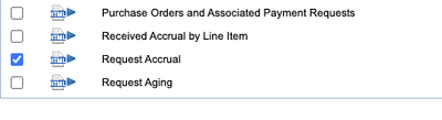

@jrmered Okay, go in using the Analysis option, not the BI Manager option. From the Public Folders area you should see one folder named Analysis - Standard Reports. Click this to drill into that folder. You will see some sub-folders. Look for one named Invoice and click on it to drill into this folder. You will see a list of reports. There should be one named Request Accrual. This should show you all Payment Requests based on the date range you select that are outstanding, meaning haven't been fully approved yet.
Now, this next part is very important. Do not run the report from this location. You want to copy the report and paste it into your My Folders. To do this check the little checkbox next to the report name (see screenshot). Next, click the Copy icon (see second screenshot). Then, click the My Folders tab and use the paste icon (see third screenshot) to paste a copy of the report. Once pasted, you can run the report by using the little blue triangle (looks like a play button) under the Actions column. When you run the report you should see a couple of date fields to enter the From and To dates. To see all of October, leave the To field as is (it will show today's date) and change the From field to October 1st. This will show all Invoices not yet fully approved for the month.
