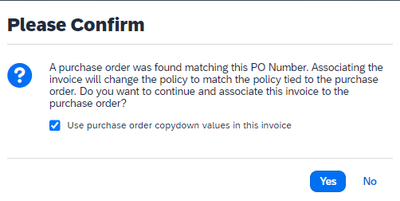

This is happening because for PO based invoices, system is configured in a way that it will always look for associated PO and copy down basic information such as expense type (associated with GL), org structure field values from PO. Usually copy down source are given as PR >> PO >> Invoice.
In your scenario, if invoice expense type/ GL is different from the PO then at the time of saving invoice header form (initial save when you are saving header info for the 1st time) system will give you pop-up window as below. Here, if you click on 'Yes' then system will copy down info from PO which means your GL/expense types will get overwrite as per PO. If you don't want to get it overwritten, then you have click on 'No' so that system will save your selected GL/expesen type.
