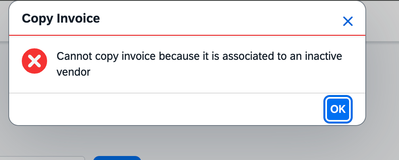

I just did a test in your site with an invoice for an inactive vendor and here is what happened. I tried to use the Copy button and received this error.

What Kevin has confirmed is correct. I also tried creating an invoice using the “copy” function, and the system displayed a pop-up window, as shown in the screenshot shared by Kevin.

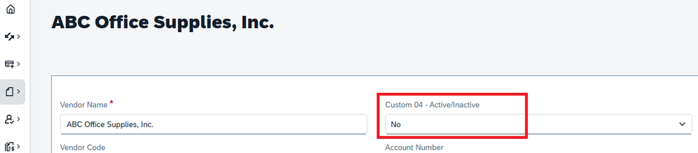

  1. Add a custom list field in the vendor form named “Active (Y) / Inactive (N)”.
  2. Set the default value to Y for all active vendors.
  3. For inactive vendors, download the list from the Vendor Manager UI and update the field value to "N".

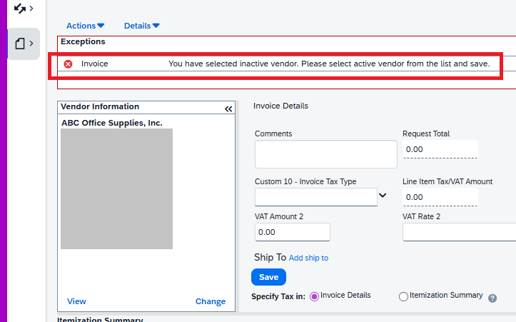

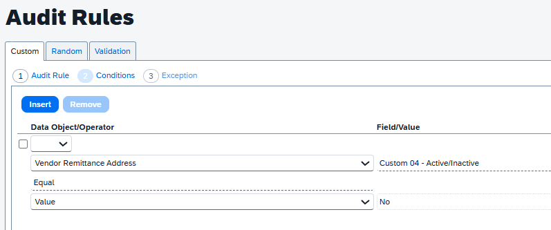

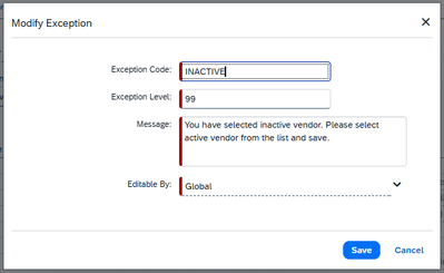

  4. Create an audit rule to check if “Active (Y) / Inactive (N)” = N; if the condition is met, trigger a hard stop message.
Note - With this setup, even if an employee creates an invoice using an inactive vendor, the audit rule will prevent them from submitting the invoice.
Update flag as "N" in vendor form either manually or through import.
First download vendors from UI, populate "N" in custom field and upload again.
Testing Screenshot:
