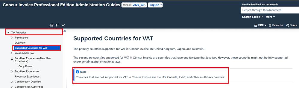

I have worked on two invoice implementation projects in the past, during which I identified several limitations within the invoice module. One such limitation is that SAP Concur Invoice does not support multi-tax country requirements. Therefore it requires manual intervention.
Attaching standard document screenshot for your further reference.
One of our client raised this requirement and concern with SAP Concur and was looking for a solution, particularly to enable automated tax calculation.
While collaborating with the Concur solutioning team, they proposed the following approach, which we tested internally to assess whether it met the client’s requirements. However, it did not fully meet expectations due to the client’s highly complex needs.
That said, I am sharing the proposed approach with you for reference. If you have simple setup, you may review it, validate it, and test it with a few sample invoices to determine whether it suits your requirements before taking any decision on proceedings.
Note - This will require API integration with Concur and few additional configuration changes in Concur system. For this you may need to take help from your integration team.
