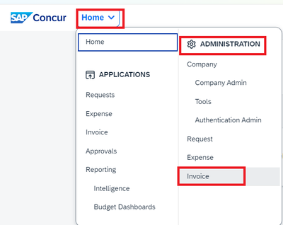

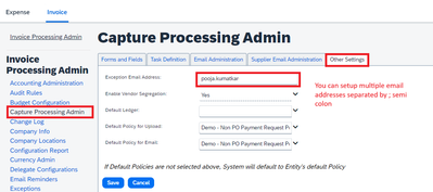

Hi @Azeez567 ,
To configure exception email, you must have Invoice configuration administrator (unrestricted) access.
Navigation:
Home >> Invoice (under Administration section)  >> Capture Processing Admin >> Other settings tab (Exception Email Address)
Thanks!
