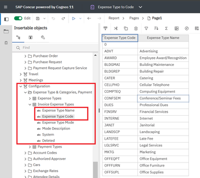

1. Create Cognos custom report in Concur. You may take someone's help who has Concur Reporting access and ask them to build this report as below. It will give you Expense type wise expense type code available in Concur system.
Sample screenshot:
2. Now using API try to get expense type wise Expense type code and compare both codes (fetched through Concur reporting and API) are matching or not. If both are matching, then try to pass same code through API and check whether your error gets resolved.
If not matching, then you will get same error.

With reference to your statement may I know how did you set expense type code manually? If possible can you please provide a screenshot from Concur where you have set this code manually.
If you are using standard expense type field then please note that for standard expense types (default expense types) system has its own default expense type code and for custom created new expense types, system will generate unique code in the backend. You cannot set any random code to it as technically it is not feasible. This codes you can check using cognos reporting which I have shown in my previous response.

We are also using the system generated code for our custom created expense types. We did used Congnos reporting to get the values and also confirmed it with a Localization export.
