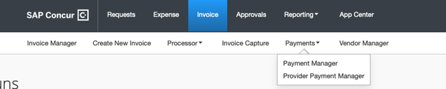

TR01_0-1625772148808.pngHow to reverse a submitted invoice other then entering a duplicate with all amounts as negative value?

@TR01 has the invoice in question been fully approved? If not, I'm fairly certain you can either recall it if you need to make changes or delete the invoice as you can see in the screenshot you provided.

@KevinD  can I void the invoice after it has been approved and extracted? We do not have the payment manager module
@RadmilaP I'm looking in your site and I do see the Payment Manager option for Invoice. If you get assigned the Payment Manager role, you should be able to void the Invoice.
