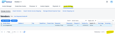

Alternatively, you can use vendor import option which is available in vendor manager UI page: (manual import)
  1. Take any existing vendor record which is available in Concur and note down its vendor code and vendor address code.
  2. Download same vendor record with the help of 'send to excel' option available on vendor manager page.  (refer below screenshot)
  3. Do the necessary changes in import file. Let say, update vendor bank or any other field value (Except vendor code and vendor address code) and save. Please note - if you are updating any value manually in concur vendor record, then please ensure, same update has been done in source system on same day. Otherwise, next day when daily job runs, it will replace today's updated value.  To avoid this, you should do the same changes in source system.
  4. Go to, vendor manager >> Vendor import >> browse your updated file and import.
  5. Check if vendor bank or field which you have updated in file, does that got updated.
Hope this would resolve your issue.
