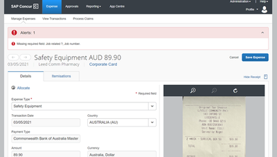

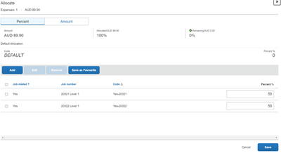

allocating to 2x job codes (..21 and ..22) and picking YES it's job related
back at the expense screen:

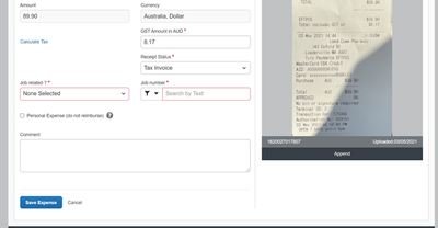

alert at the top about compulsory field.
...and at the bottom, the fields themselves not reflecting the allocation already done and saved.
