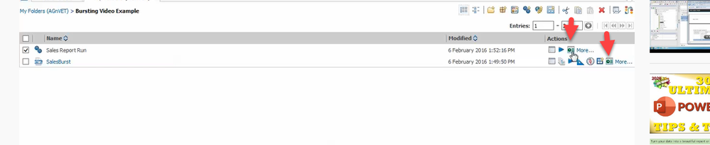

Occasional Member - Level 2
Adding a little more information. I have write access in cognos reporting, but i'm not seeing the little green schedule icon below. Not sure if this is an access issue or what ?Schedule Icon.png
TRedman
SAP Concur Employee
SAP Concur Employee
You will need to have a Cognos Professional Author role to enable the scheduling feature, this is not available to users with a Cognos Business Author role.  To confirm what you have, you can run the standard report, Employee Roles found under the administration folder.
If you do have the Cognos Professional Author role, next confirm you are using Internet Explorer. Several features do not function properly under other browsers.  If you are still unable to schedule, log a support case for our Analytics Support team to investigate further.
