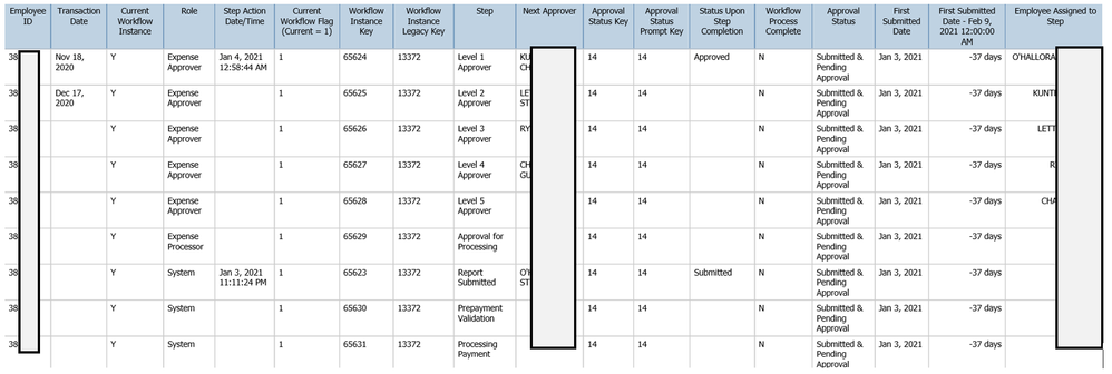

I was able to create a custom report with Column "Employee assigned to step" but it shows the current approver and the future approvers as well - Have multiple level approval flow.
Issue -
I am not able to filter the output whch would show the current approver only with whom the report is currently pending.

So, let's suppose you don't have the processor role...can you provide a screenshot of all the data items you have on your report you are building? You'll definitely need a filter, but with multiple levels of approval, it could be a tricky to know exactly what to filter on.

Thanks for getting back on this. Attaching the screenshot of the current extract - I really can't figure out which field to filter on Smiley HappyReport.PNG

Hi @tstagliano,
Even I thought so and added that column to my report already but if you look at my screenshot, all the steps have the Current workflow = 1. Can you please check in youe system if youy have similar scenario. Report.PNG

@ankit1301   Typically when we do any workflow reporting to show the most recent approver, we filter on the belwo items that work for use
- Filter on the Approver Roles within our org ("Role Legacy Key in (Auth_Approver, CO_Approver and Manager)"
- Employee Assigned to Step is not any of the System or Admin accounts
- Step Action Date/Time IS  NOT NULL
- Current Workflow Flag (Current=1) = 1
