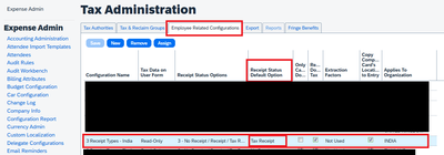

This must be happening because in your Concur site, at backend under tax administration, default receipt status has been set up as 'Tax Receipt'. System will only take No Receipt/Receipt option if it is configured as default option under tax administration. Hence, there is no issue. System behavior is correct as per configuration done at backend.
Attaching below screenshot for your easy understanding.
Thanks!

SKSK
Hi Pooja,
Thank you for your reply.
I can't reach the window you are showing.
Only the person with proper rights can access it and change the setting?
Regards,
SKSK

Hi @SKSK ,
Yes, it is a backend configuration done for your Concur site and it will be applicable for all employees. To access this configuration item, person must have Expense Configuration Administrator (unrestricted) role.
I would suggest reaching out to your company Concur Administrator and check whether they have setup 'tax receipt' as default receipt type in tax administration. You can check with them whether they can setup 'Receipt/No Receipt' as default option, however, it will be completely your company's decision what receipt type can be setup as default based on company policy.
Thanks!
