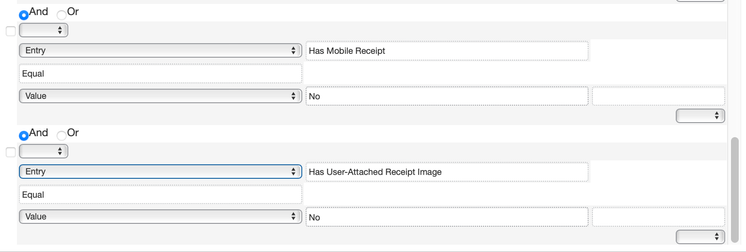

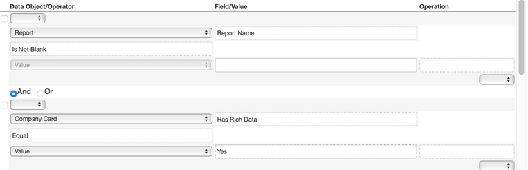

Hi Mspeir - I'm currently encountering the same issue you are with "Rich Data" as we're setting up Concur. Any chance you can walk me through how you created the Custom Audit rule that made Concur require receipts even with Rich Data? Thanks!
@MattH the screenshots below are the conditions for the audit rule you are looking for.
Hey Kevin - Thanks so much for the quick response. Couple follow ups just to make sure I am understanding how this rule works. I see the top rule references a "report". Will this setup result in the receipt required flag showing up when a user tries to create an expense report or is this to create a report that an administrator could run to ensure all expenses had receipts? Also, could you provide a road map for how to turn on the "Custom Audit" rule within Concur environment. Is this something I need to request to be turned on or can I navigate their on my own? Appreciate the help.

@MattH see my responses in red below.
I see the top rule references a "report". Will this setup result in the receipt required flag showing up when a user tries to create an expense report or is this to create a report that an administrator could run to ensure all expenses had receipts? In audit rules, Report means Expense Report. Not a report you would run.
Also, could you provide a road map for how to turn on the "Custom Audit" rule within Concur environment. Is this something I need to request to be turned on or can I navigate their on my own? You will need to request that Custom Audit Rules be turned on.
