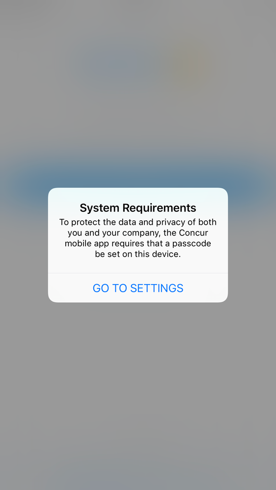

I tried uninstalling 2x and reinstalling. The mobile app is not working on my IPhone 8plus
IOS 12.3.2. I spoke to Concur support and my company- no one has an answer. A pop-up window appears saying go to settings and that i need a passcode. Under settings Concur settings is greyed out and location services will not change from never to while using App. Any suggestions? Thanks
Hi Mychel,
This message indicates that your device does not have a passcode lock set up.
For increased security Concur's mobile app does not work on devices that do not have a device passcode, PIN or screen lock set. You will need to set one up as follows:
For iOS devices, follow below steps (not in the SAP Concur mobile app, but in your system device settings):
Go to Settings > Select Touch ID & Passcode > Select Turn Passcode On > Create new password
For Android devices, follow below steps (not in the SAP Concur mobile app, but in your system device settings):
Go to Settings > Select Security > Select Screenlock > Select Password > Create New password
