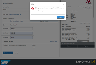

When I try to itemize my expense and save it, I receive this error: Before you can continue, you must provide valid information for: Date Range. The dates in Details page are correct, as in the receipt.

What we see that the issue is happening when we use the "Recurring Itemization" . So we suggested to go with the Single itemization by updating the Check-in Date in the date field and save the entry. Once done, then select the entry and copy the same until the total Itemized about is set to Zero. So with this there will be entry created for each day between the Check-in & Check-out date.

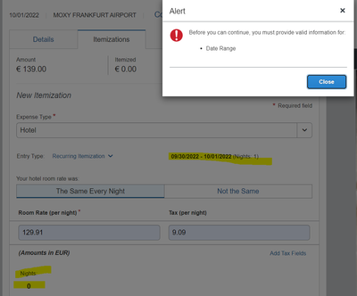

Yes the problem is still there.  See screenshot below.

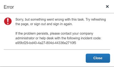

Is there a work around to have this resolved? Getting this error message when Itemizing the Hotel information. Began getting it last Thursday and still an issue today.
This error seems to be generic. Can try clearing the system Cache & Cookies to see if you could get our the error.
BW
tried this and still have the same error message.
