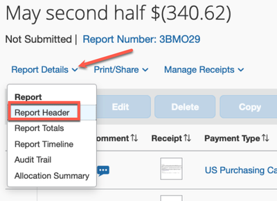

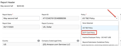

@juaproan open up your expense report and follow the screenshots below.
You also probably want to add your other P-Card transactions to this report so it won't have a negative total amount.
