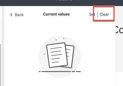

@ludovico did you preset some prompt values in the report properties and you want to reset that? If that is what you did, then you'll need to go to the folder where you have the report saved, mouse over the report name and then click the three little dots that appear. Click the three dots to open the report menu. Select Properties. After that, follow the screenshots below. Give that a try.
