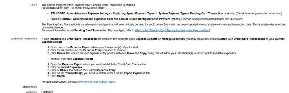

Hi @tonylmartinez72 ,
Error is getting triggered because you have selected credit card payment type while creating expense entry and not linked associated credit card transaction into your expense.
If it is a credit card entry then you should wait until that credit card transaction get imported to Concur or available under Available Expenses section. Once it is available in your profile then you can move it to the expense report. Also, for all the credit card transactions most of the standard fields such as transaction date, vendor name, amount and payment type will get auto populated by the system and those will be in read only mode.
Attaching similar article for your reference. Please try suggested solution and check if it gets resolved.

@tonylmartinez72 do you see a Citi card transaction in your Available Expenses? If so, you can match it to the Hertz Car Rental item. Although the amounts are slightly off, the amount charged to the Citi card will override the amount shown on the Hertz item when added to your expense report.
If the Hertz item is sitting on an expense report, then take the Citi card charge for the rental car and add it to the same report. Once both items are on the same report, click the checkbox that you see to the left of each item. When both items are selected, you can use the Combine button to merge the two expenses. This will clear the Alert.
Let me know if you have any issues trying this.
