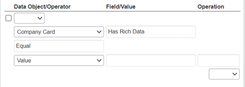

@jsmith-bbi I believe Level 3 Data is also referred to as Rich Data. Here is a screenshot. Rich Data or Level 3 data refers to the credit card charge, so if you are making a condition based off of the Entry and looking for Rich Data, you won't find it. The condition needs to be based on the Data Object of Company Card.
Let me know if this helps/works.

Can someone share the settings, as I have been unable to figure this out?
TIA!
This solution is not for 3rd tier receipts but E-receipts, i have to play around to discover where 3rd tier receipts are but must be in this list, good luck .
Thanks, I was able to find the e-receipt settings and adjusted accordingly. However, I have been unable to find anything related to 3rd tier, aka Level 3 Data. If someone does find it, please share.
thanks again!
@jsmith-bbi As Emeril says, "BAM"! Glad it works for you.
