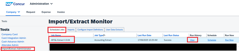

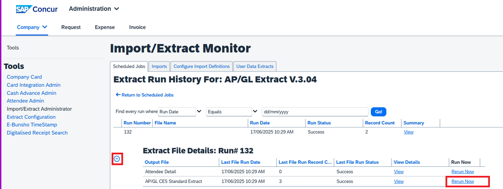

SFTP Flat file Integration Extract:
  • If you are using SFTP flat file integration method then technically it is feasible to re-push entire SAE file with the help of Import/Extract Administrator Access.
  • Role Required - Expense Configuration Administrator (Unrestricted)
  • Note - Only with unrestricted access, you will get Import/Extract Administrator role by default.
  • To re-run SAE follow below navigations:
Note - When using SFTP flat file integration, when you re-run SAE, entire SAE file will be re-pushed to ERP. To exclude any specific reports from the SAE, technically it is feasible to modify extract configuration definition based on testing requirement, however, this is restricted configuration item and available ONLY for the Concur and users who have unrestricted configuration access and have required knowledge to modify the same.
