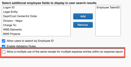

3. Ask your site admin to turn on the option below:
I hope this helps. 🙂
Thanks for sticking with me! That seems to cover the situation "well enough". That hidden option (I have no idea who the "site admin" would be that I'd ask...) is the closest to addressing my use case - it's like "consolidating expenses" but at the other end. Same result.
