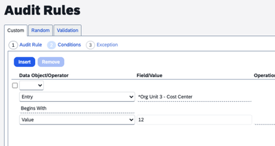

The audit rule conditions do not allow for wildcards, however I was playing around and noticed that there is an option in the conditions for Begins with. So, if your Cost Centers are simply numbers, you might be able to use this option. I know when you do list set up you enter a Name and Code, but if your name happens to also be the code, this could work. Look at my screenshot below. For your scenario, you would need three additional conditions that say begins with 13, begins with 14 and begins with 15. Each would be separated using the "Or" operator.
You could easily test this out if you have a test group set up. Create the rule and have it apply to the test group only. Anyway, let me know if you try it out and if you do, I want to hear if it works or not.

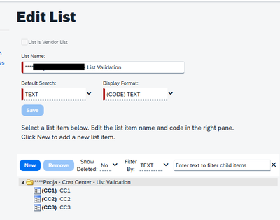

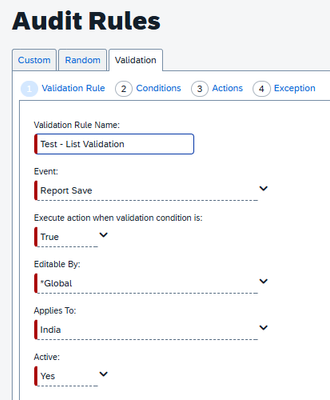

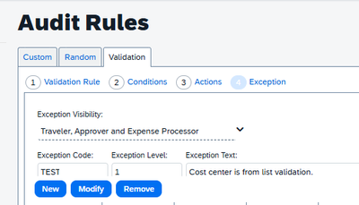

Just for your easy understanding purposes I'm sharing some sample testing screenshots:
1. in List management - > Created sample list which i want to compare with the actual cost center list.

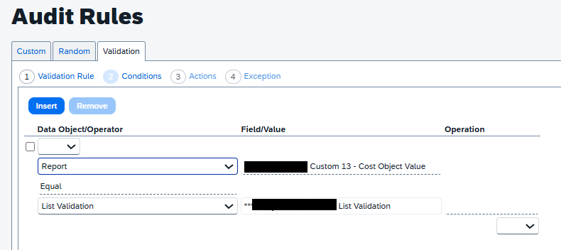

2. Go to Audit Rules >> validation tab

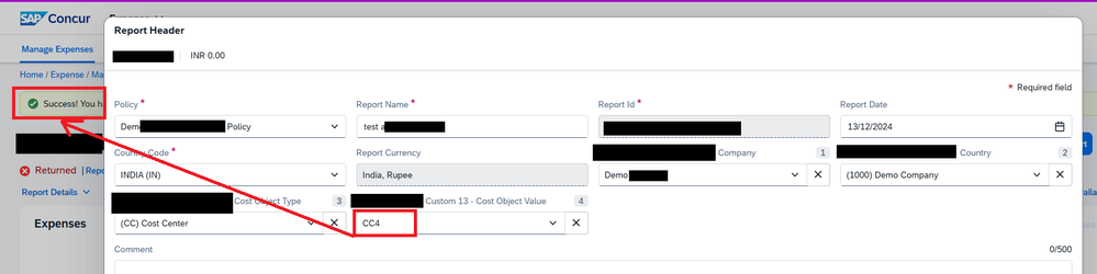

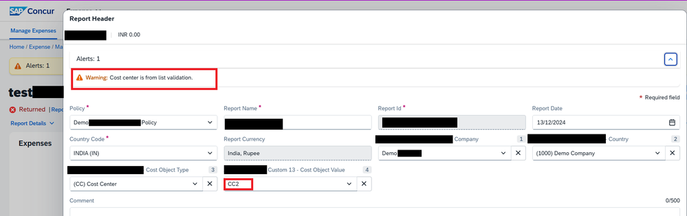

Testing Result:
Scenario 1: If user selected cost center is from list validation, system will trigger warning message.
Scenario 2: If user selected cost center is OTHER than list validation, system will NOT trigger warning message.
Warning disappeared.
