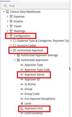

Hi, I was wondering if there is a report showing approval limits for all users and where to find it?
Solved! Go to Solution.
@AMA If you go into Cognos you can build a simple report to show Authorized Approvers and their limits. See screenshot. Hopefully you have some Cognos experience. ๐

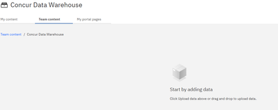

Thanks for replying @KevinD . Unfortunately my Concur data warehouse is empty and I have just taken over SAP C from the person who left, not sure how to manage it in depth but happy to learn if you could point out any resources I could use.
@AMA your data warehouse isn't empty, you just need to choose the data warehouse as your source when you start a new report. ๐
