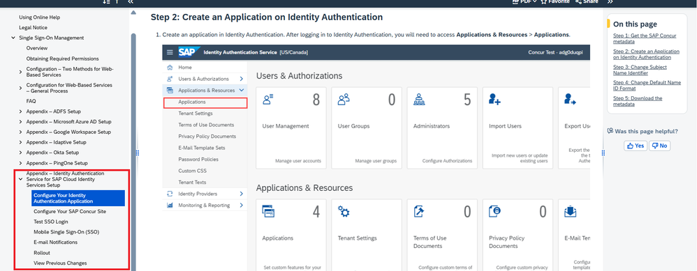

This is not my core area of expertise; however, I did some research and found the information below. You may review and validate whether it is feasible in your scenario. I am also sharing the standard SAP Concur documentation for your reference.
https://help.sap.com/docs/SAP_CONCUR/8b1fb4bc53c843c080bcfc4b965366a1/39a497e06d184d89b93bff91d5fb8f...

Recommended Architecture
1. Set IAS as the central IdP for both Concur tenants
  • Configure both Concur A & B to trust IAS (not Azure AD directly)
2. Configure Azure AD as upstream IdP in IAS
