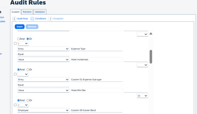

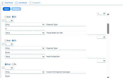

Hi @grodriguezproje actually, I was able to include some and or conditions and issue got resolved after few testing . Let me show the screenshot actually for what I did.
Actually was getting confused using and /or and brackets. But after lot of testing was able to figure it out.
