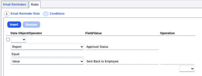

@Twoodrum2025 yes you can. Are you wanting this for all employees? If so, your Email Reminder rule condition would look like the following.
Then when you are setting up the Email Reminder itself, set the Frequency to Daily.
I'm guessing you are familiar with setting up Email Reminders or are you not?
