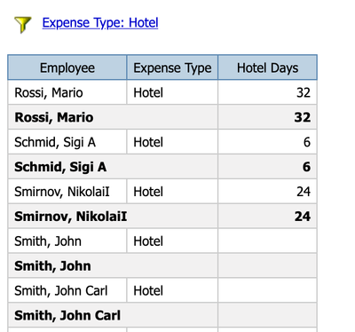

@laura_wilkin See screenshot. This should get you started. I did this in Query Studio. A couple of things to note:
1. Be sure to Group the Employee column/data item.
2. After grouping, click Hotel Days and then click Edit in the left Menu. Select Summarize. You'll see an option appear at the bottom of your report with a drop down field. Select Average from this list.
3. You will need to add some sort of date data item so you can filter for last year.
