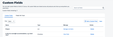

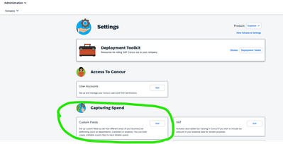

@KevinD Thanks for getting back to me. I've found the Custom Fields entry from SAP Concur Home/Administrator / Custom Fields - screenshots below. I've the option to add up to 12 Custom Fields (more than enough for what I need). I've taken a look through the warehouse and haven't yet found where these fields appear (operator error not yet ruled out!) - I'll go back and take a closer look.

@BriP25 so you are on our Standard version. I believe the first few custom fields you add will use the Org Unit fields in the data warehouse. When you are in the data warehouse, there should be a search field. Simply type in Org Unit and it will show you where these fields are in the data warehouse.
