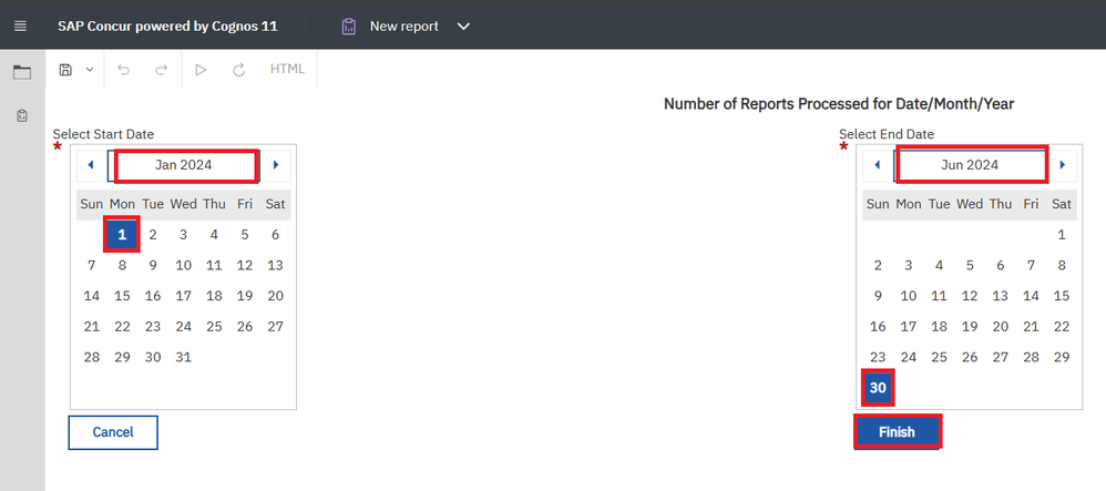

Sample Screenshot from our sandbox:
Output (number of processed reports list) based on selected date range:
