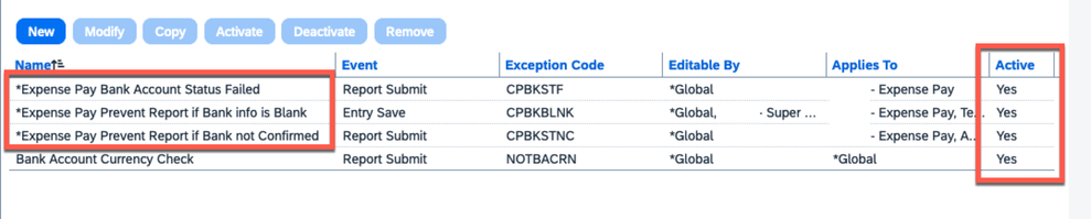

THANK YOU! It turns out we did have this existing audit rule but it was applied to an incorrect user group. A Concur rep was able to assist me in fixing & testing this.
@chloerossman these audit rules are already created and are provided out of the box. Your site already has these rules active. It is possible that the users affected are not part of a group that these rules apply to. See my screenshot below showing your site has these rules active. I would check the audit rules to see which groups they are applied to, then check the user profiles to see which group the users are assigned to make sure there is a match. My guess is the users are in a group that the rules aren't applied to. I took the screenshot directly from your site. No need to create the rules.
