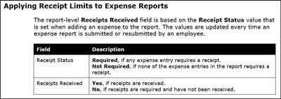

Hello, I found an issue when testing Receipt Limits today and have confirmed that with testing a limit with condition that would require a receipt in Concur Expense Professional, the user could not submit the expense report until they had attached a receipt, which they did and then submitted the report, but in the Processor View the report shows the Receipt Status as "Received / Not Required"
Manual shows:
We have 2 active Receipt Limit rules for the US Group that should have been evaluated against this expense entry (only expense on the report) and a limit rule did work because the user was required to attach a receipt before they could submit.

@USWsdymerski that field is in case a company requires hard copy receipts, which I'm guessing you do not. Therefore, this field is not applicable. I would suggest hiding it from your processor view by using the List Settings button.
