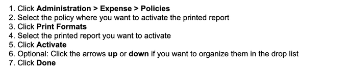

@USWsdymerski new print reports are activated at the Policy level. If you have access to modify policies, then follow the steps below. If not, contact Concur Support.

Solution

Thank you SO MUCH! I didn't know the steps and couldn't find anything in online help. It is working for us now - THANKS AGAIN!
