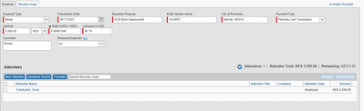

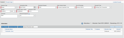

@otariq I went back and looked at your KCB Bank Deployment expense report and found corporate card transactions on this report that match the pending items you are asking about. As I said earlier, it is very likely the pending items you think haven't posted yet are likely already on a submitted report and that is why you have to look closely at your past reports. I've provided an example below.
This screenshot is from your submitted report named KCB Bank Deployment
Here is a pending item from your Expenses not Processed report
These two items are the same expense. The amounts are slightly different as far as USD, but in KES the amounts are the same. The dates match and so does the vendor. So, this is one example of the expense already being posted and submitted by you. As I went through your list of pending items and the items submitted on the KCB Bank Deployment, I found a credit card charge that matches each of these pending items. Since you have already submitted these pending items on the KCB Bank Deployment report, you can just delete all these pending items from off the Expenses not Processed report.
