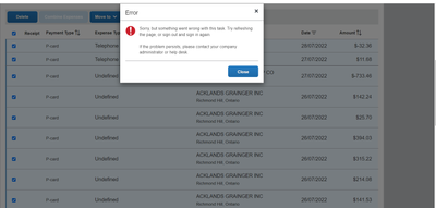

I tried that To New Report and I got the message below:
@dougb1298 are you still receiving this error message?

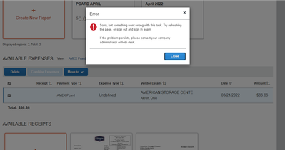

I am having this issue. I have available expenses but they will not move on to a new claim statement.
@lindamckenzie without seeing the message you received about why they won't move, I have to guess that you are trying to use corporate card transactions to a P-Card Statement report.
Corporate card transactions and P-Card transactions, in most cases, are handled a little differently in SAP Concur. A lot of our customers require P-Card transactions to go on a statement report, not an expense report.
This sounds like issue you have. If you send me a screenshot of the message you receive when you try to move these items to a new claim, I can better help you.
