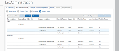

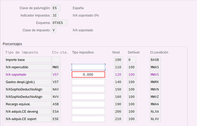

The TAx configuration is correct:
And Concur configuration we think also is correct:
