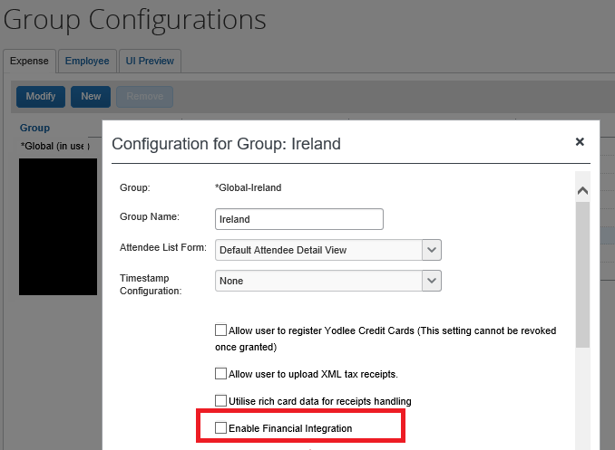

There is a configuration setting called "Enable Financial Integration" in Expense Admin-->Group Configurations. This setting is unfortunately not visible for customers, only Concur administrators/supporters.
It needs to be activated (either by Concur support via opening a case or by your implementation consultant) for every group configuration, for which you want to post Expense reports to SAP via native integration (the SAE extract is not affected by this setting).
As long as this setting is not activated you'll always get the response "No documents found” ({# "fIDocuments" : [ ],# "offset" : null,# "nextPage" : null,# "numberReturned" : 0#}") in the SAP AddOn. Additionally there is a "Manual Pay" button in the "Expense Processor view" for every expense report in that group ...
I guess this setting was not activated for your new group configuration.

Well, we had the same problem in a recent roll-out of a new country and yes, we had to create the expense reports, that were created with the setting turned off, from scratch, because they were not picked up by the SAP AddOn after turning on the integration setting.
Fortunately we found the problem fast, so not many reports were affected yet ... that's why we decided to rather create them quickly instead of finding a generic solution.
But maybe - in case for you this issue is already affecting a lot of reports - it makes sense to address this also to Concur Support. There must be a technical solution also.
