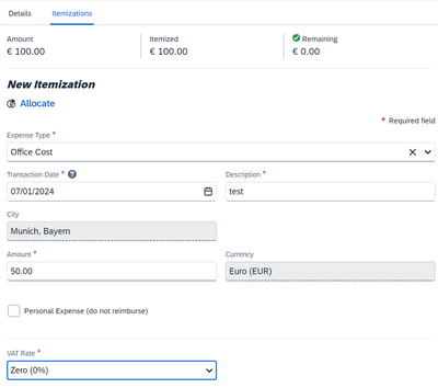

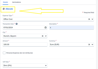

Hi @Gallia
I'm not sure if the word allocation is the right one according with the example you mentioned.
Allocation is mainly to split a expense between different cost objects not to differentiate between Tax Rates.
For example: You want to split an Office cost expense type (Let's say 100 euros) between 2 Cost centers (50% will go to Sales for example and 50% will go to Finance) the VAT will be the same for both, so the posting will look like this:
Debit Office Expense 50 euro (Sales cost Center)
Debit Office Expense 50 euro (Finance cost Center)
Credit Vendor (100 euro)
I think what you need to use is what @KevinD mentioned the Itemization feature. When you use it in the main window the users are asked to inform a VAT Rate according to the form assign it to the expense type, but the system at the end will use the ones in the itemization (please check the screenshots below) where you have 1 part with VAT and one without.
i hope this helps
