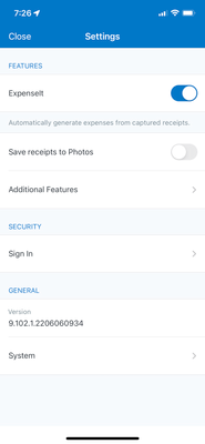

@KevinD  I have to check on the “Mobile Auth Lifetime” and yes one user is using biometrics  and another isn’t using biometrics. And regarding sign in policies, i dont see “other settings” option on the mobile app to see sign in policies.please see the attached picture, please advise.
@Vamsi Other Setting is only found on the Web version of SAP Concur. Profile>Profile Settings>Other Settings.
