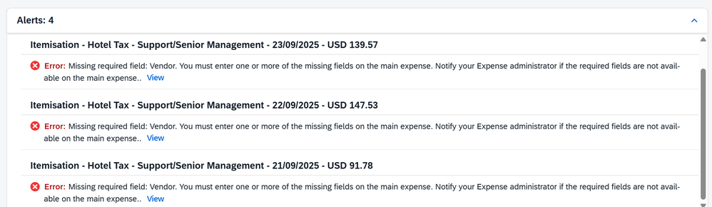

Next step is, when I see everything has been itemized appropriately (or I think it has been) I can still see 4 alerts, and everytime I click on view the system does nothing for me...
Please find attached what I can see but I cannot move forward, neither submit the claim
Not sure how I can submit my expense report
Also, if there's any other channel (faster such as Teams, live chat etc...) would also be much appreciated so I can submit them on time, my boss can approve them, then I can get that money back
Thanks again for your enormous help, much appreciated
@almainforma open the expense entry and enter in a Vendor name. This will copy down to your itemizations. For some reason the field is required although it doesn't have the little red asterisk that shows it is required.
Give that a try and see if the alerts clear up.
