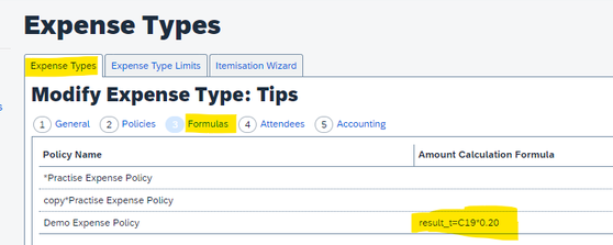

3. Go to Expense types >> search for 'Tips' and double click >> go to 3rd step/page which is for formulas and update below formula >> next >> next >> done.
result_t=C19*0.20
Note: Here you can replace C19 with any custom field which you have added in your form. Remember to only replace custom field number.

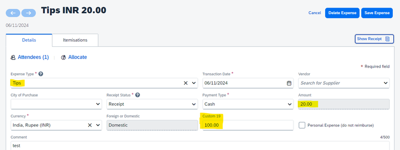

2. Add expense 'Tips' >> fill in the required information. Here you would observe that Amount field must be in read only. Add your total tip Amount into custom field (example, custom 19) and save expense.

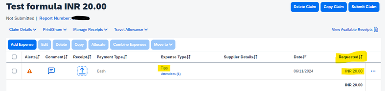

3. Now on summary page, you would observe, 20% of Tip amount has been auto calculated by the system which will reflect under requested column as shown below.
