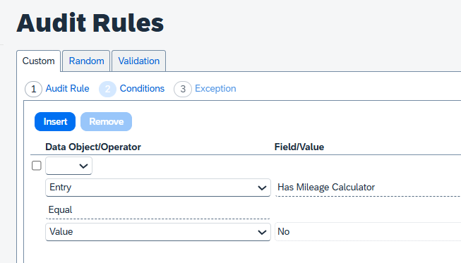

Hi @joeabraham ,
Based on the screenshot given by KevinD i am assuming that your company is using Concur Standard Edition. I dont have much idea about Standard Edition configuration.

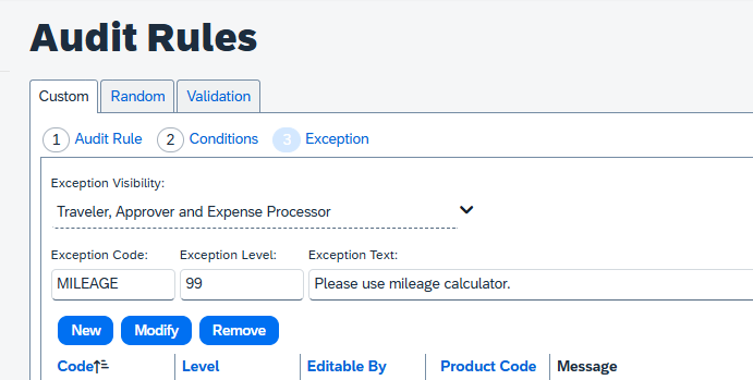

However, if data objects are same as per Professional Edition then you can try writing below audit rule. Basically 'Has Mileage Calculator' data object is used to check whether user has used Mileage Calculator or not to generate locations or whether it is manually entered.
Audit Rule:
Event - Entry Save
Testing Result:

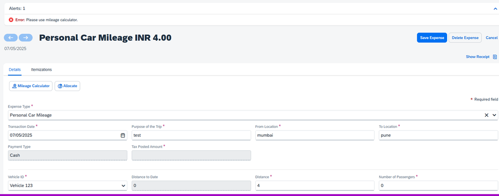

Edition - Concur Professional
Since I have manually entered locations, upon expense save, audit rule got triggered. If you use Mileage Calculator then exception msg will disappear.

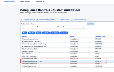

@joeabraham all that setting does is automatically opens the Mileage Calculator when a user selects the Mileage expense type. If you want to prevent users from changing the calculated mileage to enter a mileage amount that is greater than what was calculated, then you can use the Custom Audit rules option. There is a rule already created that you can simply activate that would flag expenses where the changed mileage is 10% or more than what was calculated. See screenshot.
Now, the rule is currently set to Warn the user. I checked and this cannot be changed. If you want to Block report submission, create a new rule using the same conditions. You will just need to create a new Exception on the last step of the rule creation that uses the Block option instead of Warn.
If you have any issues, let me know.

Hi @joeabraham ,
Audit Rule:
Event - Entry Save
Testing Result:
If this answers your query then please mark solution as accepted.

Thank you Pooja, this works! I've added another layer of an Audit rule to make sure people don't adjust the mileage after using the calculator.
