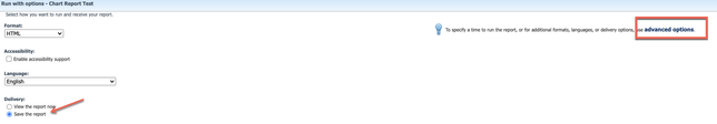

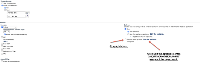

Now, the limitation of this date prompt is that you won't be able to schedule the report. The reason is, you need to make a date range selection before the report can run. You will need to manually run the report each time so you can select the appropriate date range from the prompt. You can have the report email automatically every time you run the report. Just be sure when you run the report, you choose the option to Save the report, DO NOT choose View Now.  To email the report, you will select the advanced options (see screenshot). The advanced options will allow you to email the report (see second screenshot).
Each time you need this report with the new dates, follow these steps. Unfortunately since you are spanning two different months, you cannot have the Last Month filter and another filter to tell it to add the last day of the month before the last month.
